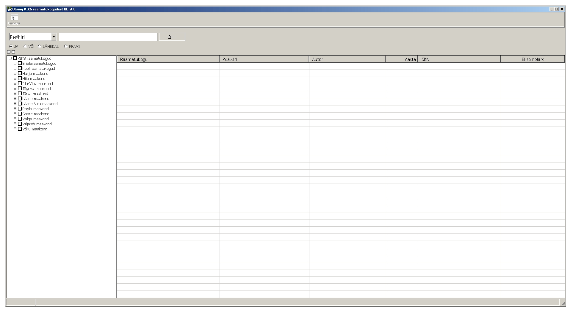

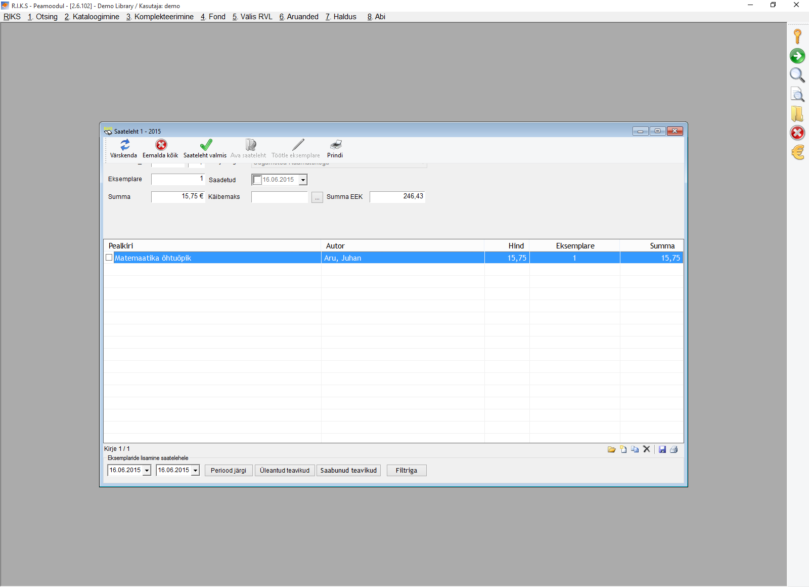

I'm testing your controls under Windows 10 TP and discovered strange problem with ReBar+ToolBar when using align - Top.
On my form i have my own custom control aligned to top (first control) and then ReBar+ToolBar aligned to top (second control).
Under Windows XP and 7 i have not noticed this problem, but under Windows 10 the ReBar alignment is messed up. When I resize form, ReBar's alignment is set to 0(see screenshots), but when i click on form where rebar+toolbar should be placed, rebar "jumps" to right place where it's positioned at design time.
Any ideas?

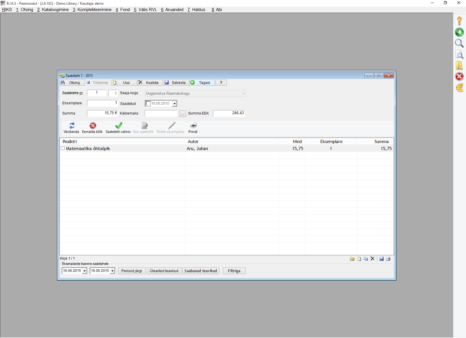

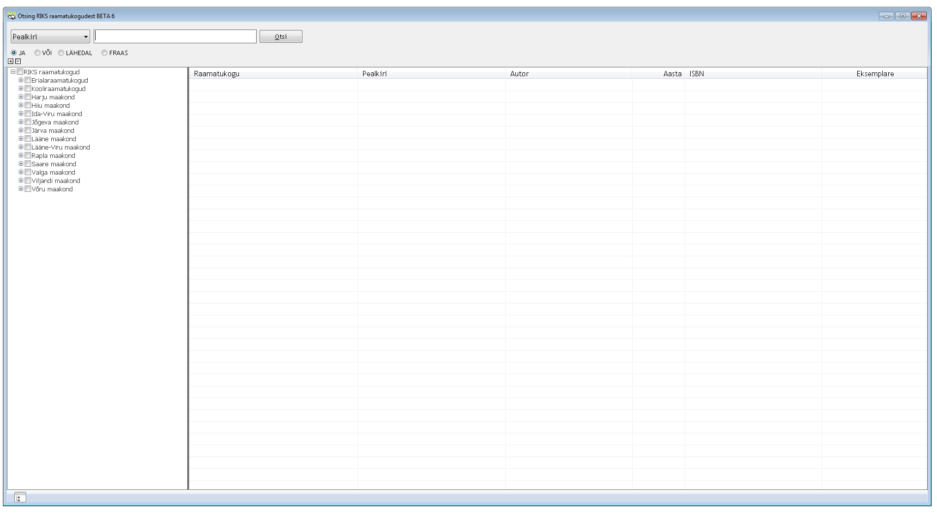

I found another strange problem with rebar and i cant figure out, what's causing this. I think it has something to do with rebars height and/or border.
1) On my form i have rebar as first top aligned control
2) Second top aligned control is picture box
3) Third top aligned control one my own contol
When classic theme is used, rebar is at top, but when theme is enabled, then rebar is last control (see pictures)
(346.56 KiB) Not downloaded yet
(281.37 KiB) Not downloaded yet
