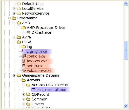

Re: Filter Results
Hello TiKu,
this was a great step forward. There are no more hook-ups in "Function Find_Next_Match_In_Sub_Tree"! But now the code skips filter results, which are located on the same level as the first founded result of the corresponding level.
Hoping you are willing to continue working on the problem (my trials to solve it failed all) I attached a screenshot, which illustrates the problem better than a longwinding explanation: after the code found the first blue colored result ("cfgmgr.exe"), it skips the red colored ones and jumps to the second blue marked ("oss_reinstall.exe"). This always happens if a filter result has siblings.
If you graduated successfully: Congratulations and all the best for your professional future!
Thanks in advance for your reply (whatever you are saying) and
best regards
aka
best regards
aka
